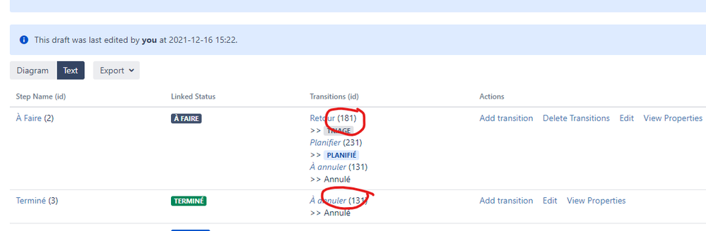

You could use the transition id. If the name of the transition change, the Id won't.
You can easily find the Id of you transition by going in workflow edition mode:
