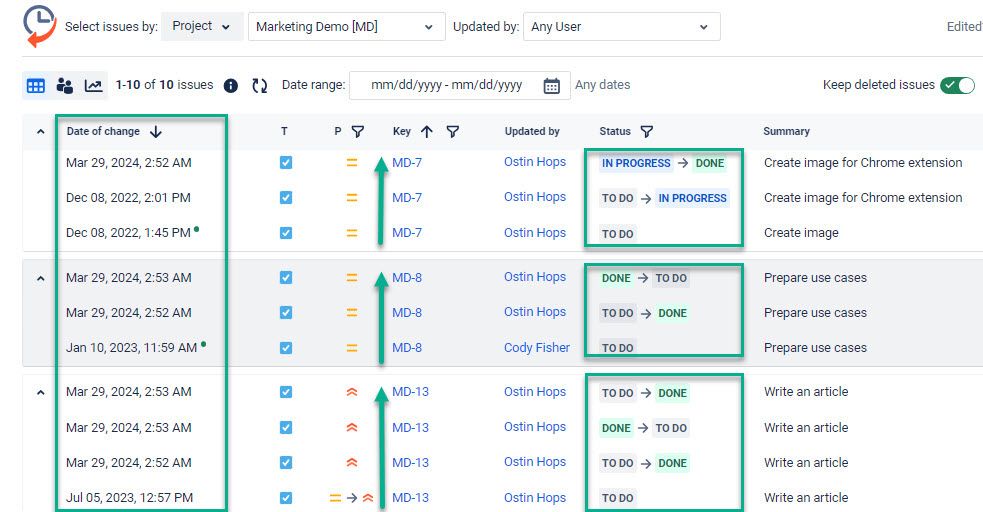

  • Issue History for Jira allows you to create a report with all status transitions or select a specific status.Jira status transition history dates.jpg

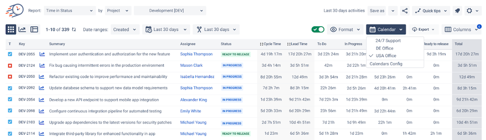

  • Time in Status allows to get a report of the Status Entrance Date and Time issue spend in status

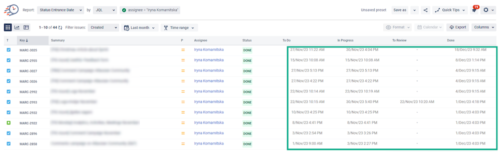

Status Entrance Date Report – This report automatically shows the exact date when a ticket last entered "Blocked" status. No need for custom scripts or API calls.

Time in Status Report – Helps calculate how long the issue remained blocked, providing better insights for process optimization.

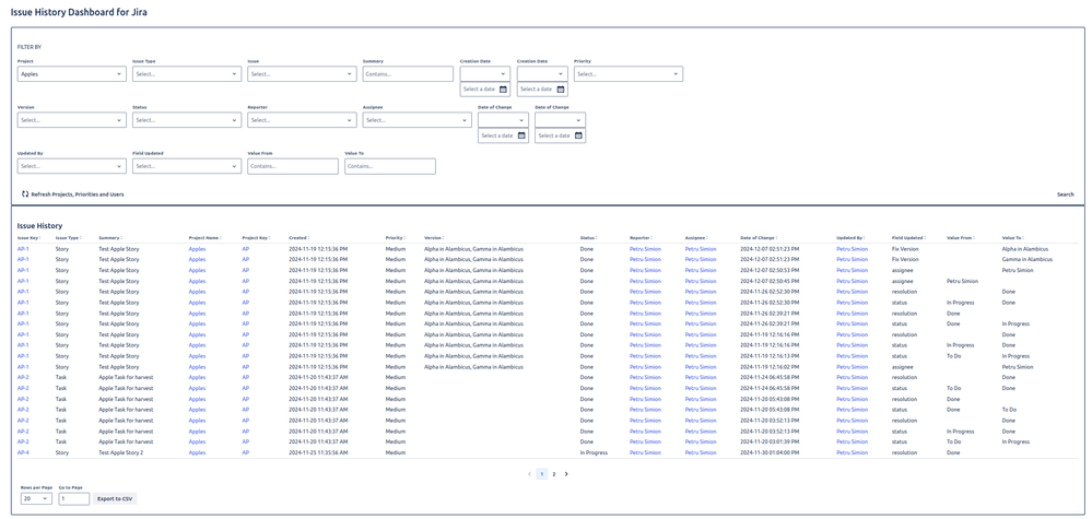

If you are just interested to depict a certain transition that represent the time the ticket got blocked and later calculate yourself the time you could use Issue History Dashboard for Jira .
You can search for all issues in a project  or filter by various criteria.
The result will show you what field was updated, when, by whom and the value changed from and value changed to.

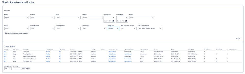

On the other hand, if knowing how much time the issues have spend in each status, would suit your purpose, you can use Time in Status Dashboard for Jira .
You can also search for all issues in a project or filter by various crieteria.
The result will show how much each issue spent in each status of the workflow the issue was transitioned into at least once. The time will be cumulative, in case the issue was transitioned into a status more than once. You will also be able to see how many times the issue was present in each status.
You can then sum up the time spent in various statuses, to calculate what your company considers time spent for a "blocked" issue. You can later drill in more into data, calculate using Excel formulas or whatever other system you want to input your csv format data into, and create your own charting.
