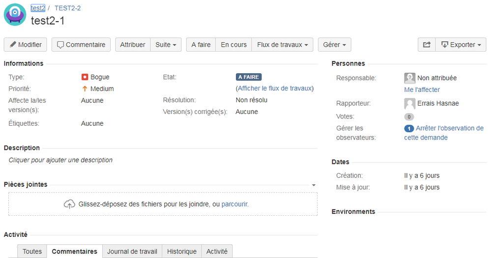

I don't really understand what you mean about the "context" but I will tell what i am about:
When clicking to the issue Item in Jira server it'd display (normally) an environment zone showing the list of environments of the current project. So I've guess that maybe i can get the project Id from the HttpServletRequest in the doGet method in my servlet.
I've never initialized that "issue" and i don't know it's gonna stand for what? Should I declare it as an IssueService or Issue or what?

Hasnae E
August 1, 2017
Thanks. But it's still not that clear to me to determine which context my code is running..
Would I need to determine the context even when trying to get the issue id as well?
Nic Brough -Adaptavist-
August 1, 2017
Yes, you need that context.  You've said "web panel" a couple of times, but never explained where this will be located.  It could be on the side of a fridge for all we know (context - no JIRA context, so code will need to fetch data), but I suspect it's being added into the JIRA UI - question is "where?", as that's going to determine the context.
Hasnae E
August 1, 2017
It is located in the issue screen.. just like that :
Hasnae E
August 1, 2017
here is the code of my webpanel :
<web-panel name="Environments" i18n-name-key="environments.name" key="environments" location="atl.jira.view.issue.right.context" weight="100">
<description key="environments.description">The Environments Plugin</description>
<context-provider class="com.atlassian.tutorial.myPlugin.Servlet.MyContextProvider">
<param name="itemCount" value="4"/>
</context-provider>
<resource name="view" type="velocity"><![CDATA[<iframe src="/plugins/servlet/issuecrud"></iframe>]]></resource>
<tooltip key="gh.issue.panel.reference.tooltip"/>
</web-panel>
and the servlet indexed by "issuecrud" is where i want to retrieve the issue id.
Hasnae E
August 2, 2017
Any suggestion?
