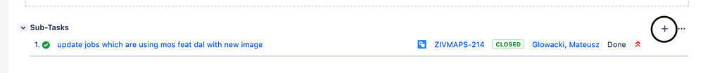

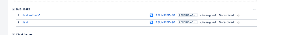

In one of My JIRA parent issue, I do see the '+' sign to add more sub tasks but in the another project's Parent issue I do not see.
I can only add sub task using More --> Sub-tasks.

Both the projects are having Sub-task and manually I am able to create Sub-tasks (Using More --> Create Sub-task) , I created one sub tasks in both the project's issue, but Plus sign comes only with one Project.
