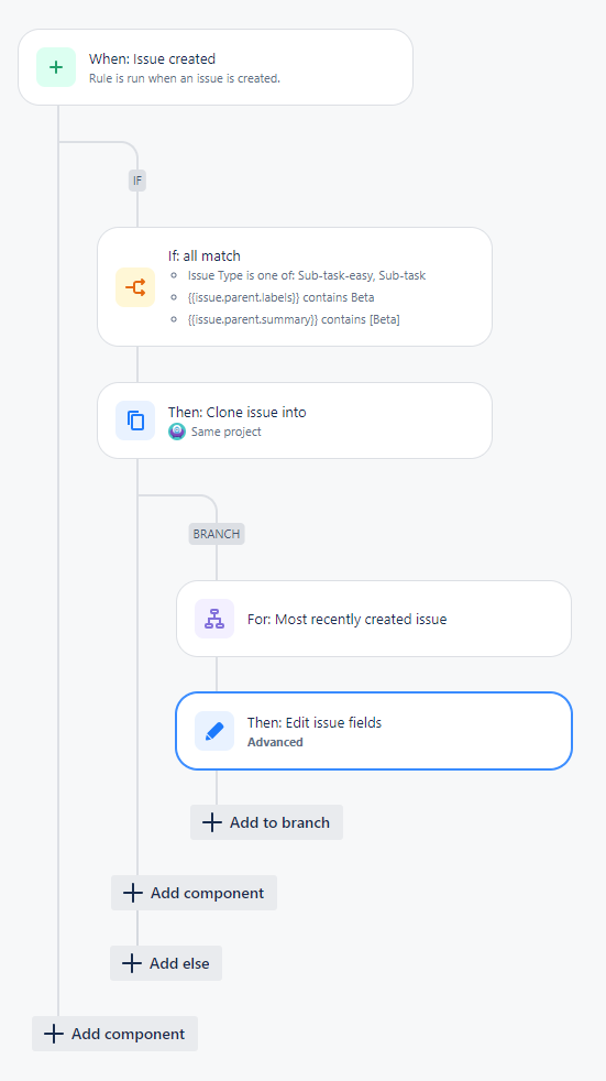

After @Bill Sheboy helped me understand how filtering lists works, I could fix my automation.
Just in case somebody needs a similar automation I will leave the details here. :)
When a Subtask is created the automation clones it and afterwards uses "for: most recently created issue" to edit the Parent (which assignes it not to its own Parent, but the Issue the Parent was cloned from).
So this Automation is for Issues where you want a copy from and if you add Subtasks you want to make sure they are going to be in the original issue as well.

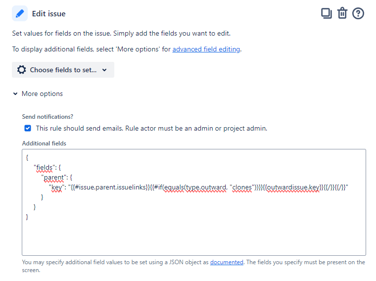

for copy paste:
"key": "{{#issue.parent.issuelinks}}{{#if(equals(type.outward, "clones"))}}{{outwardissue.key}}{{/}}{{/}}"
In general I learned filtering the lists works with the link direction wich are: inward and outward (or both).
So in our case above as it is "clones" it uses "outward". If it was a "is cloned by" link it would be inward.
