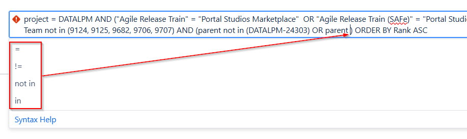

Second, I don't have the "is" operator for parent as shown in the pictureimage.png

Have you done this as a linkage? Or you have put a value in the Parent Link field? If you add the Parent field to the screen, is it populated?
For the "is" problem, try using parent = ""
jviola
March 16, 2026
Indeed, we have a value in the Parent Link field and the parent field is empty, that's why.
Thanks for your help
