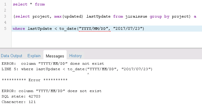

Hi Support,
But we want to dynamic use this SQL,not just use to_date?
How could we revise to current - 6 months ?
SQL error message as below(our database is postgresql)

January 22, 2018
select * from
(select project, max(updated) lastUpdate from jiraissue group by project) a
where lastUpdate <
now() - interval '6 month'
