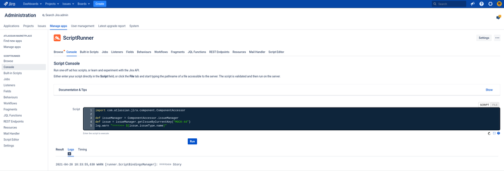

Below is a print screen of the console for your reference:-
I hope this helps to solve your question :)

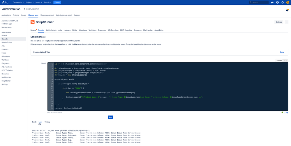

Below is a print screen of the code along with the output:-
