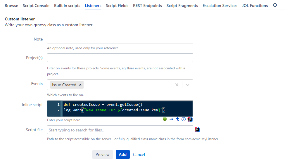

Yes it will work when you configure your listener for Issue Created event. here is how your setup will look like:
Gaurav Jain
July 2, 2019
Thanks it worked.
