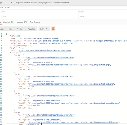

Christos Moysiadis
March 13, 2020
well i tried now in Jira 8.8 and its working perfectly.
GET > http://localhost:8080/rest/api/2/project/10400/workflowscheme

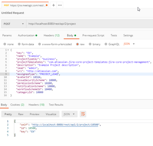

Christos Moysiadis
March 13, 2020
Sorry for the late response!
I just made the test now. As you can see in the following images , yes i could succesfully create one :)
2020-03-13 23_47_29-Postman.png2020-03-13 23_47_54-Browse projects - JiraTESTTEST.png
