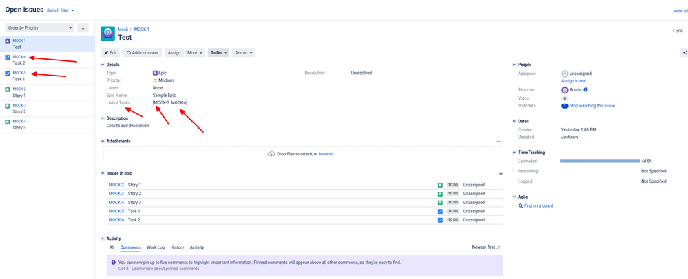

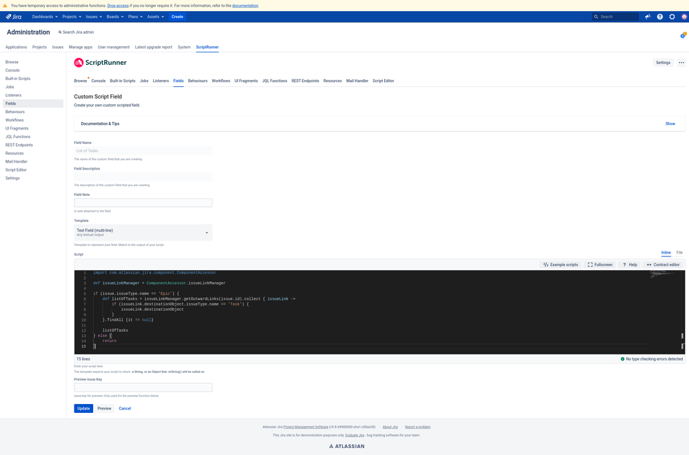

Below is a screenshot of the Scripted Field configuration:-
Below is a test output:-
If you observe the screenshot below, as configured in the Scripted Field code, it will only display all Task issue types that belong to the epic.
