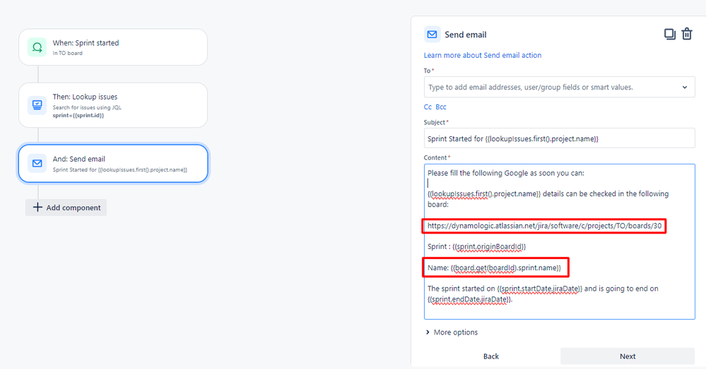

This is what I am doing ...the automation rule triggers when a new sprint is started.
Since I am running multiple boards with multiple sprints, I have to manually enter the sprint url...
Also, the sprint name is not working.
@Asha Goyal @Bill Sheboy @Craig Nodwell
