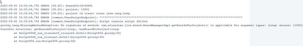

 And here you see the error message:
I do not understand why the signature of the method "getBoardsForProjects()" is not correct.

Hi Niranjan,
oh what a silly typo...thanks for this hint!! Now I don't get an error message from the system anymore.
But to be honest, I only reached the next question...the list of the boards as a result of the boardManager method "getBoardsForProject()" is empty, although the projects have boards.
So I guess there is another problem beneath the typo...any additional idea?

Hi @Günter Halmans - I believe that is getBoardsForProject(long projectId) and not getBoardsForProjects(project.id)
