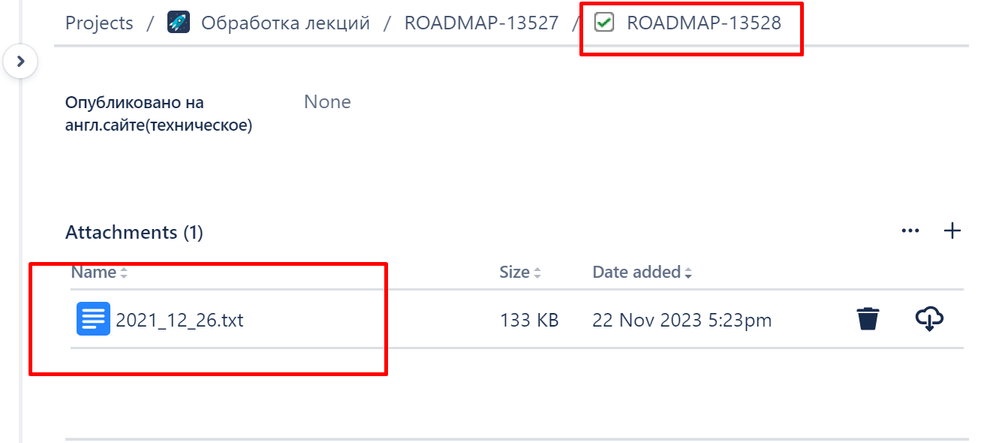

Hi,
Issue ROADMAP-12811 has .txt attachment.
I need to get the attachment ID by issueKey with REST API.
I tried
/rest/api/2/issue/ROADMAP-12811
/rest/api/2/issue/ROADMAP-12811?fields=attachments
but it doesn't return attachmets data.
There is a lot of methods to work with attachments
https://developer.atlassian.com/cloud/jira/platform/rest/v3/api-group-issue-attachments/#api-rest-api-3-attachment-content-id-get
But how to get attachments ID of current issue? We are using Jira Cloud.

rest/api/2/issue/ROADMAP-13528
There is no attachment field in response
{"expand":"renderedFields,names,schema,operations,editmeta,changelog,versionedRepresentations,customfield_10010.requestTypePractice","id":"20388","self":"https://bvgoswami.atlassian.net/rest/api/2/issue/20388","key":"ROADMAP-13528","fields":{"statuscategorychangedate":"2023-11-18T18:00:15.406+0200","issuetype":{"self":"https://bvgoswami.atlassian.net/rest/api/2/issuetype/10005","id":"10005","description":"(Migrated on 11 Nov 2023 09:29 UTC)","iconUrl":"https://bvgoswami.atlassian.net/rest/api/2/universal_avatar/view/type/issuetype/avatar/10551?size=medium","name":"Обработанная лекция","subtask":true,"avatarId":10551,"hierarchyLevel":-1},"parent":{"id":"20387","key":"ROADMAP-13527","self":"https://bvgoswami.atlassian.net/rest/api/2/issue/20387","fields":{"summary":"2023.11.01 - Тестовая","status":{"self":"https://bvgoswami.atlassian.net/rest/api/2/status/6","description":"The issue is considered finished, the resolution is correct. Issues which are closed can be reopened.","iconUrl":"https://bvgoswami.atlassian.net/images/icons/statuses/closed.png","name":"Closed","id":"6","statusCategory":{"self":"https://bvgoswami.atlassian.net/rest/api/2/statuscategory/3","id":3,"key":"done","colorName":"green","name":"Done"}},"priority":{"self":"https://bvgoswami.atlassian.net/rest/api/2/priority/10004","iconUrl":"https://bvgoswami.atlassian.net/images/icons/priorities/trivial.svg","name":"Trivial","id":"10004"},"issuetype":{"self":"https://bvgoswami.atlassian.net/rest/api/2/issuetype/10004","id":"10004","description":"A task that needs to be done. (Migrated on 11 Nov 2023 09:29 UTC)","iconUrl":"https://bvgoswami.atlassian.net/rest/api/2/universal_avatar/view/type/issuetype/avatar/10318?size=medium","name":"Исходная лекция","subtask":false,"avatarId":10318,"hierarchyLevel":0}}},"timespent":null,"customfield_10030":null,"project":{"self":"https://bvgoswami.atlassian.net/rest/api/2/project/10001","id":"10001","key":"ROADMAP","name":"Обработка лекций","projectTypeKey":"software","simplified":false,"avatarUrls":{"48x48":"https://bvgoswami.atlassian.net/rest/api/2/universal_avatar/view/type/project/avatar/10419","24x24":"https://bvgoswami.atlassian.net/rest/api/2/universal_avatar/view/type/project/avatar/10419?size=small","16x16":"https://bvgoswami.atlassian.net/rest/api/2/universal_avatar/view/type/project/avatar/10419?size=xsmall","32x32":"https://bvgoswami.atlassian.net/rest/api/2/universal_avatar/view/type/project/avatar/10419?size=medium"}},"customfield_10031":{"self":"https://bvgoswami.atlassian.net/rest/api/2/customFieldOption/10020","value":"Аудио","id":"10020"},"customfield_10032":null,"customfield_10033":null,"fixVersions":[],"customfield_10034":"01:58","aggregatetimespent":null,"customfield_10035":56.8,"resolution":{"self":"https://bvgoswami.atlassian.net/rest/api/2/resolution/10001","id":"10001","description":"A fix for this issue is checked into the tree and tested.","name":"Разрешен"},"customfield_10036":"2023-11-01","customfield_10037":{"self":"https://bvgoswami.atlassian.net/rest/api/2/customFieldOption/10071","value":"2023","id":"10071"},"customfield_10027":null,"customfield_10028":null,"customfield_10029":null,"resolutiondate":"2023-11-18T18:00:12.074+0200","workratio":-1,"issuerestriction":{"issuerestrictions":{},"shouldDisplay":false},"lastViewed":"2023-11-22T17:23:04.270+0200","watches":{"self":"https://bvgoswami.atlassian.net/rest/api/2/issue/ROADMAP-13528/watchers","watchCount":1,"isWatching":true},"created":"2023-11-18T18:00:02.873+0200","customfield_10020":null,"customfield_10021":null,"customfield_10022":null,"priority":{"self":"https://bvgoswami.atlassian.net/rest/api/2/priority/10004","iconUrl":"https://bvgoswami.atlassian.net/images/icons/priorities/trivial.svg","name":"Trivial","id":"10004"},"customfield_10023":null,"customfield_10024":null,"customfield_10025":"1_*:*_1_*:*_9238_*|*_6_*:*_1_*:*_0_*|*_10005_*:*_1_*:*_3311","labels":["асат-тришна","изучение_шлок","нанда"],"customfield_10026":null,"customfield_10016":null,"customfield_10017":null,"customfield_10018":{"hasEpicLinkFieldDependency":false,"showField":false,"nonEditableReason":{"reason":"PLUGIN_LICENSE_ERROR","message":"The Parent Link is only available to Jira Premium users."}},"customfield_10019":"0|i036fb:","timeestimate":null,"aggregatetimeoriginalestimate":null,"issuelinks":[],"assignee":{"self":"https://bvgoswami.atlassian.net/rest/api/2/user?accountId=557058%3Ac46e31e6-5873-4c83-9d0f-bd28b09ab162","accountId":"557058:c46e31e6-5873-4c83-9d0f-bd28b09ab162","emailAddress":"dizzycome@gmail.com","avatarUrls":{"48x48":"https://secure.gravatar.com/avatar/cc26658d1d99b6c981723d8d035246fe?d=https%3A%2F%2Favatar-management--avatars.us-west-2.prod.public.atl-paas.net%2Finitials%2FL-5.png","24x24":"https://secure.gravatar.com/avatar/cc26658d1d99b6c981723d8d035246fe?d=https%3A%2F%2Favatar-management--avatars.us-west-2.prod.public.atl-paas.net%2Finitials%2FL-5.png","16x16":"https://secure.gravatar.com/avatar/cc26658d1d99b6c981723d8d035246fe?d=https%3A%2F%2Favatar-management--avatars.us-west-2.prod.public.atl-paas.net%2Finitials%2FL-5.png","32x32":"https://secure.gravatar.com/avatar/cc26658d1d99b6c981723d8d035246fe?d=https%3A%2F%2Favatar-management--avatars.us-west-2.prod.public.atl-paas.net%2Finitials%2FL-5.png"},"displayName":"Лилия Галимова","active":true,"timeZone":"Europe/Moscow","accountType":"atlassian"},"updated":"2023-11-22T17:23:14.321+0200","status":{"self":"https://bvgoswami.atlassian.net/rest/api/2/status/6","description":"The issue is considered finished, the resolution is correct. Issues which are closed can be reopened.","iconUrl":"https://bvgoswami.atlassian.net/images/icons/statuses/closed.png","name":"Closed","id":"6","statusCategory":{"self":"https://bvgoswami.atlassian.net/rest/api/2/statuscategory/3","id":3,"key":"done","colorName":"green","name":"Done"}},"timeoriginalestimate":null,"customfield_10051":null,"customfield_10052":null,"description":"Описание лекции","customfield_10053":1.0,"customfield_10010":null,"customfield_10054":"<b>текст лекции</b>","customfield_10055":"MLzVyNvNuYQ","customfield_10056":null,"customfield_10057":"Тестовая","customfield_10058":null,"customfield_10014":null,"customfield_10015":null,"timetracking":{},"customfield_10059":null,"customfield_10049":null,"customfield_10005":null,"customfield_10006":null,"security":null,"customfield_10007":null,"customfield_10008":null,"customfield_10009":null,"aggregatetimeestimate":null,"summary":"2023.11.01 - Тестовая","creator":{"self":"https://bvgoswami.atlassian.net/rest/api/2/user?accountId=557058%3Ac46e31e6-5873-4c83-9d0f-bd28b09ab162","accountId":"557058:c46e31e6-5873-4c83-9d0f-bd28b09ab162","emailAddress":"dizzycome@gmail.com","avatarUrls":{"48x48":"https://secure.gravatar.com/avatar/cc26658d1d99b6c981723d8d035246fe?d=https%3A%2F%2Favatar-management--avatars.us-west-2.prod.public.atl-paas.net%2Finitials%2FL-5.png","24x24":"https://secure.gravatar.com/avatar/cc26658d1d99b6c981723d8d035246fe?d=https%3A%2F%2Favatar-management--avatars.us-west-2.prod.public.atl-paas.net%2Finitials%2FL-5.png","16x16":"https://secure.gravatar.com/avatar/cc26658d1d99b6c981723d8d035246fe?d=https%3A%2F%2Favatar-management--avatars.us-west-2.prod.public.atl-paas.net%2Finitials%2FL-5.png","32x32":"https://secure.gravatar.com/avatar/cc26658d1d99b6c981723d8d035246fe?d=https%3A%2F%2Favatar-management--avatars.us-west-2.prod.public.atl-paas.net%2Finitials%2FL-5.png"},"displayName":"Лилия Галимова","active":true,"timeZone":"Europe/Moscow","accountType":"atlassian"},"subtasks":[],"customfield_10040":"1.1","customfield_10041":{"self":"https://bvgoswami.atlassian.net/rest/api/2/customFieldOption/10089","value":"Русский","id":"10089"},"customfield_10042":"Говардхан","reporter":{"self":"https://bvgoswami.atlassian.net/rest/api/2/user?accountId=557058%3Ac46e31e6-5873-4c83-9d0f-bd28b09ab162","accountId":"557058:c46e31e6-5873-4c83-9d0f-bd28b09ab162","emailAddress":"dizzycome@gmail.com","avatarUrls":{"48x48":"https://secure.gravatar.com/avatar/cc26658d1d99b6c981723d8d035246fe?d=https%3A%2F%2Favatar-management--avatars.us-west-2.prod.public.atl-paas.net%2Finitials%2FL-5.png","24x24":"https://secure.gravatar.com/avatar/cc26658d1d99b6c981723d8d035246fe?d=https%3A%2F%2Favatar-management--avatars.us-west-2.prod.public.atl-paas.net%2Finitials%2FL-5.png","16x16":"https://secure.gravatar.com/avatar/cc26658d1d99b6c981723d8d035246fe?d=https%3A%2F%2Favatar-management--avatars.us-west-2.prod.public.atl-paas.net%2Finitials%2FL-5.png","32x32":"https://secure.gravatar.com/avatar/cc26658d1d99b6c981723d8d035246fe?d=https%3A%2F%2Favatar-management--avatars.us-west-2.prod.public.atl-paas.net%2Finitials%2FL-5.png"},"displayName":"Лилия Галимова","active":true,"timeZone":"Europe/Moscow","accountType":"atlassian"},"aggregateprogress":{"progress":0,"total":0},"customfield_10001":null,"customfield_10002":null,"customfield_10046":"2023.11.01 - Тестовая.mp3","customfield_10003":null,"customfield_10004":null,"customfield_10048":null,"customfield_10038":{"self":"https://bvgoswami.atlassian.net/rest/api/2/customFieldOption/10073","value":"парикрама","id":"10073"},"customfield_10039":{"self":"https://bvgoswami.atlassian.net/rest/api/2/customFieldOption/10081","value":"бхагавад-гита","id":"10081"},"progress":{"progress":0,"total":0},"votes":{"self":"https://bvgoswami.atlassian.net/rest/api/2/issue/ROADMAP-13528/votes","votes":0,"hasVoted":false},"comment":{"comments":[],"self":"https://bvgoswami.atlassian.net/rest/api/2/issue/20388/comment","maxResults":0,"total":0,"startAt":0},"worklog":{"startAt":0,"maxResults":20,"total":0,"worklogs":[]}}}
