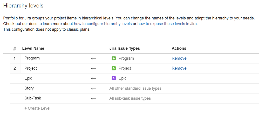

We have setup heirarchy using  portfolio for JIRA like below.
Program -> Project -> Epic -> Story -> Sub-Task
We have the following issue types
Program
Project
Epic
Story
Sub-task

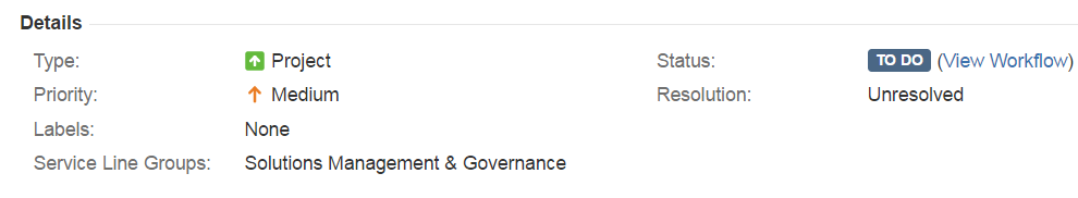

I am having issues with the above kind of code in 'Validators' because it is not taking the current status of the 'Issue' that just got updated.
'Project' is an Issue Type, which is above the Epic.

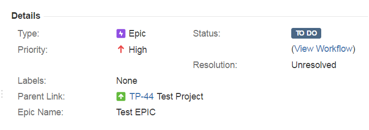

On 'EPIC' we have Parent Link to 'Project'
