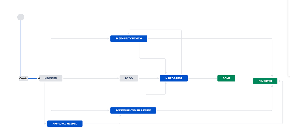

I probably have something wrong on the setup still. On the create function, I have a Set Issue Fields post function that sets the Software Owner Approver to the user in I specified.
I can test with the issue that the statement returns true. It also returns true for the post function that you gave me.
Here is how the workflow looks:
All those post functions are on the Create step. Essentially, when that Software Owner Approver equals to that account, it should take the transition from Create to To Do.
The Software Owner Approver is not in the screens for the issue. Could that affect this? We didn't have it in the screen setup in Server prior.
David Fischer
November 3, 2022
Can you share the list of post functions from the transition view?
If I understand correctly, you have two post functions on the Create transition, one that sets the Software Owner Approver field, then one that transitions the issue. In that case, you need to understand that post functions do not run in order in Jira Cloud. The only way to guarantee the execution order is to use a Sequence of Post Functions post function and put both existing post functions in it.

As for my question, this should work. The Create step only assigns the user ID I mentioned above, based on a condition. There would be no other user value assigned until the next transition occurs.
Alexander Nezis
November 7, 2022
Hey David,
Thank you so much for the solution. After incorporating both to our workflow, the requests are following the correct status based on the custom fields.
I appreciate your help on this as it completely solved our issue.
