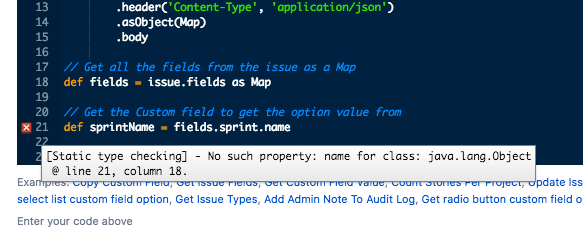

Thank you for the response. The script returns the following error at line 21:
[Stack type checking] - No such property: name for class: java.lang.Object
WOW, the error message in the script console is incorrect. This script works, which means my other scripts were working before but I wasn't running them due to the error message. 8hrs down the drain.
Thank you for your help.

I can confirm that Static Type Checking errors are just warnings where the compiler does not understand the code as described here and that scripts will still run with these type checking warnings.
