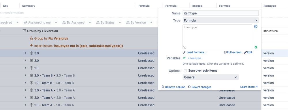

That it's not working for you is strange.  To check what itemtype = should be, please add a new formula column to your structure and add only itemtype.
It should look like this:
What you see in the field should be swapped out where I have "version".
Please let me know if this helps.

Jayadev
September 22, 2022
Hi David,
Thanks for further help. While adding the rules to the structure, I have grouped fixedversion as an attribute. Post amending it to field, the logic has started giving the desired result.
