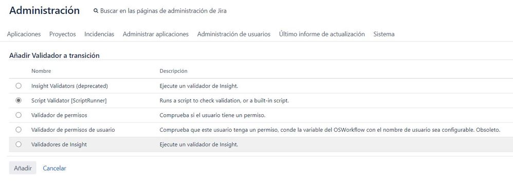

I need a custom field to be mandatory only when solving or canceling the ticket.
If I define the custom field as mandatory, it is invalid, because I only need to fill it in when resolving or canceling the issue.
I have checked the "workflow validations" but can't find any valid ones.

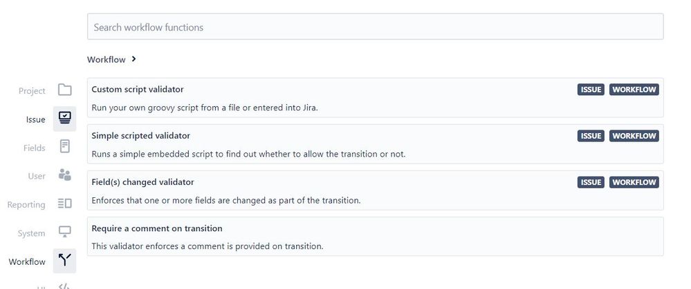

As you have mentioned, I think it is necessary to install the Utilities Suite (JSU Automation Suite for Jira Workflows - Server Version) to change a field to mandatory during the workflow. But that Suite of Utilities is not free.
Is it possible to use a "Custom script validator" or "Simple scripted validator" to make a custom field mandatory during the workflow?
Thank you

I have seen this:
https://confluence.atlassian.com/jirakb/make-custom-fields-required-in-a-workflow-transition-in-jira-server-691011903.html
I have already created the transition screen, but when I go to create the validation to change the field to mandatory, no valid option appears.
Thank

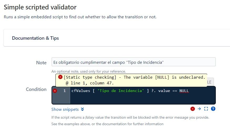

Hi @Prueba Cliente Edu ,
Definitely, it will work in ScriptRunner Simple scripted validator however it may need a bit of coding to make it work in a Transition Screen (You have to detect the name of the Transition Screen and do the validation)
Here's the condition, make sure to update it with the name of your custom field.
cfValues['My Single Select']?.value == NULL
For reference:
https://scriptrunner.adaptavist.com/5.3.7/jira/recipes/workflow/validators/simple-scripted-validators.html
Prueba Cliente Edu
January 22, 2021
Thank you very much for your answer.
I'm doing it, but it returns the following error:
How can I solve it? Thank
