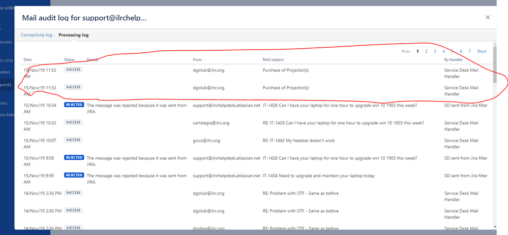

Here is the logs

That makes no sense given the large separation between the numbers. Have you scrutinized these two issues closely? Is the create date and time the same? I am wondering if you have some email handler addon that is causing this. I would reach out to Atlassian support.

that is certainly interesting. Does this happen with every email sent to that address? Here are my thoughts....
  • I'm suspicious that something outside of Jira is causing this, i.e. the email server is somehow issuing two emails. Do you have the login creds for that email? If so I would log in an watch to see if two emails are coming into the inbox.
  • check the email logs - Jira settings > products > email requests and scroll down to find your project and click the view log link
  • is it possible that you or someone has created a JSW email handler for the same email address? Jira settings > system > incoming email
