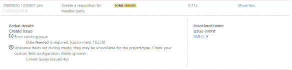

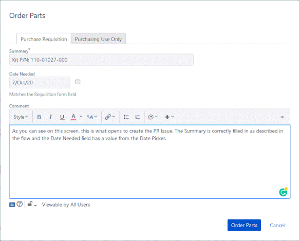

I've tried to create an issue in a different project using automation and it fails for the following errors. The Date needed field gets filled out when the new issue creation window opens. See the picture below the audit screen.

Hi @Danno ,
When creating an issue in the PR project it is therefore required that the "Date Needed" field is filled.
Where is this field set up required, do you know that? (That this field is required can be, for example, a validator on the create transition in the workflow of project PR.)

Yes, the Date Needed field is currently a required field (it is set as required in the field settings) in the Purchase Req. project and I do enter a date when it comes up in the create issue screen as you can see in the above screen shots. I do find it interesting that the screenshot I have doesn't have the red asterisk that indicates Date Needed is a required field like on the Summary Field The only validator in the Create transition is the system one of "Only users with Create Issues permission can execute this transition."
I do not have anything in the automation rule to set a date for that field. I also do not know what the second warning message means except that it might be indicating that the rule has already failed on the Date Needed step and so it ignores the create linked issu part of the rule which seems to be what is happening.

You want to create an issue in project PR via the automation rule. But because the field "Date Needed" is mandatory when creating an issue in project PR, the issue is not created and that is what the first error says.
And I think that also gives you the 2nd error, that there is no issue to link.
