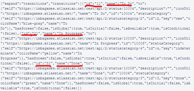

I followed the guidelines from GitLab and input the API request to the browser, here is the result:
{"expand":"transitions","transitions":[{"id":"11","name":"To Do","to":{"self":"https://imbagames.atlassian.net/rest/api/2/status/10004","description":"","iconUrl":"https://imbagames.atlassian.net/","name":"To Do","id":"10004","statusCategory":{"self":"https://imbagames.atlassian.net/rest/api/2/statuscategory/2","id":2,"key":"new","colorName":"blue-gray","name":"To Do"}},"hasScreen":false,"isGlobal":true,"isInitial":false,"isAvailable":true,"isConditional":false},{"id":"21","name":"In Progress","to":{"self":"https://imbagames.atlassian.net/rest/api/2/status/10005","description":"","iconUrl":"https://imbagames.atlassian.net/","name":"In Progress","id":"10005","statusCategory":{"self":"https://imbagames.atlassian.net/rest/api/2/statuscategory/4","id":4,"key":"indeterminate","colorName":"yellow","name":"In Progress"}},"hasScreen":false,"isGlobal":true,"isInitial":false,"isAvailable":true,"isConditional":false},{"id":"31","name":"Done","to":{"self":"https://imbagames.atlassian.net/rest/api/2/status/10006","description":"","iconUrl":"https://imbagames.atlassian.net/","name":"Done","id":"10006","statusCategory":{"self":"https://imbagames.atlassian.net/rest/api/2/statuscategory/3","id":3,"key":"done","colorName":"green","name":"Done"}},"hasScreen":false,"isGlobal":true,"isInitial":false,"isAvailable":true,"isConditional":false}]}
 How to know which one is Transition ID?
I underscored names and IDs of the statuses in your response payload
