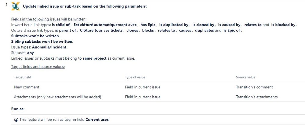

Thanks @David Fischer , I didn't think I could add the issues simply with the operator "+". As for the reason to do this, Here is a screenshot of the actual post-function implemented with another plug-in that you will surely recognize, and which I want to rewrite with JMWE.
Several link types (but not all), several fields updated, all in a single post-function. The JMWE "Set field value" allows to set value for only one field. If I had to rewrite this specifying only one link type, I would have to add (number of link types)x(number of fields to be updated) post-functions !
JMWE has multiple benefits compared to the other plug-in, but the ability to set value for multiple fields at once is clearly missing.
