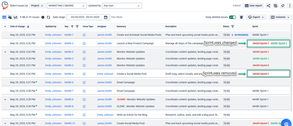

Issue History for Jira app from my team may be able to help you with this. It tracks changes over time and can show when issues were added to or removed from a sprint, including after the sprint has begun. Also, it helps to see the issues where the sprint was changed.
Additionally, the app offers filtering and export options, which are useful for reviewing or examining changes in sprint scope during retrospectives.
I hope it can help you with your task of identifying issues that were removed from a sprint.

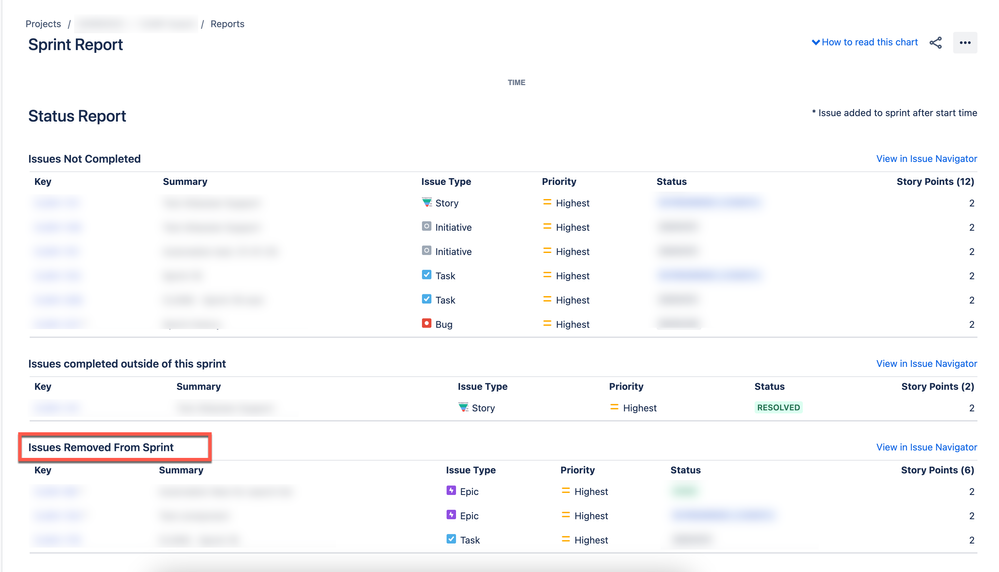

Hi @Dharmender Yadav
You have the Report available for this if you know the Sprint Report that displayed the work item removed from the Sprint.
https://support.atlassian.com/jira-software-cloud/docs/view-and-understand-the-sprint-report/

You can review the Sprint report to get this info. Select Reports from the left menu in your board and go to Sprint Report.
Select the required sprint from the drop-down. The issues completed, not completed (moved to next sprint or backlog) and removed from the sprint are listed in the report.
Example:
