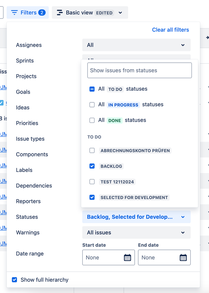

Hey @Evgenii Pugin
The steps you've mentioned sound correct. You need to select the required statuses in the filter. Please make sure other status categories are unchecked at the top. For example, with the below setup, it will only show me the issues from the 'Backlog' and 'Selected for Development' statuses.
I hope this helps. If you notice anomalous behaviour, please share a screenshot of the status filter from your plan.

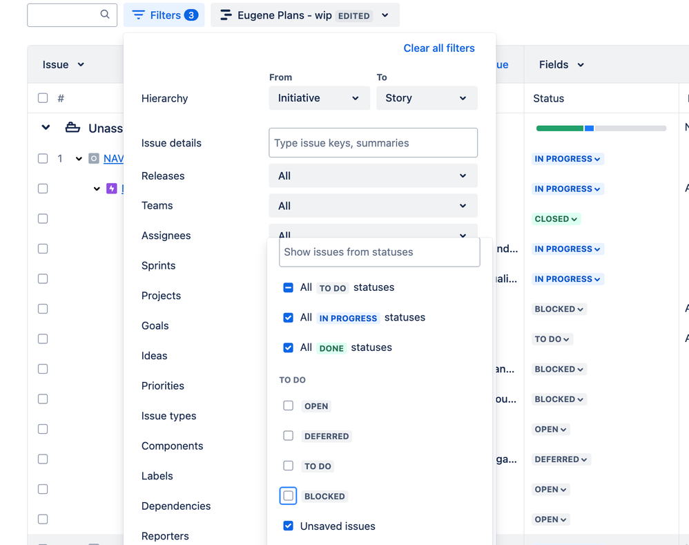

yeah, but it is not working -
e.g. here you can see status BLOCKED is unchecked,
though the tickets with this status are still shown
Evgenii Pugin
April 2, 2025
it is working well
if your hierarchy is set from Initiative to Epic

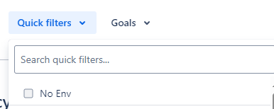

Try this:
1. Create a quick filter
2. From the timeline select the quick filter
Evgenii Pugin
April 2, 2025
excuse me, @Luca Miceli  - I do not see Quick Filters at my view
should it be anyhow configured to be visible?
as far I understand, quick filters belong to the board, right?
so, in which board could I create quick filters to be visible at Jira Plans?
