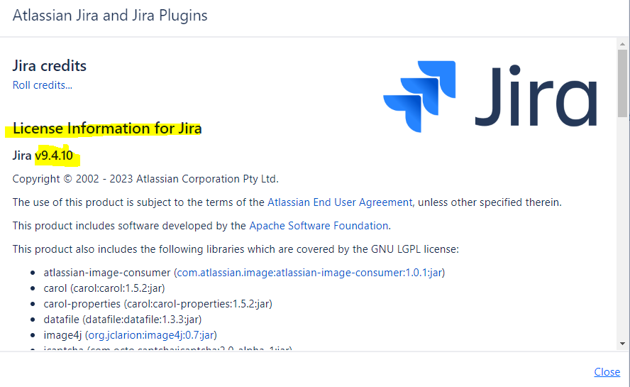

I am new to JIRA , can you tell me how can i confirm if iam using Jira cloud or datacenter.
Bill Sheboy
May 6, 2024
That version information indicates you are not on Jira Cloud; I do not believe there is any UI in Jira Cloud showing version information (except for the addons / apps).
