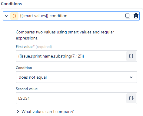

So I have built automation to use an IF for :  {{issue.sprint.name.substring(7,12)}}  "does not equal"  LSUS1
The problem I'm hitting, is that if a story has been in multiple sprints, then I might get an array of results coming back:
In my debug I print out what that produces:
Debug: LSUS1, LSUS1, LSUS1, LSUS1, LSUS1 is not LSUS1
So a string comparison there fails.
I could switch to "does not contain", but that's problematic because if the history shows that ID just once, then the rule would not trigger.
I need to get to just "current sprint" somehow.   Any clues ?

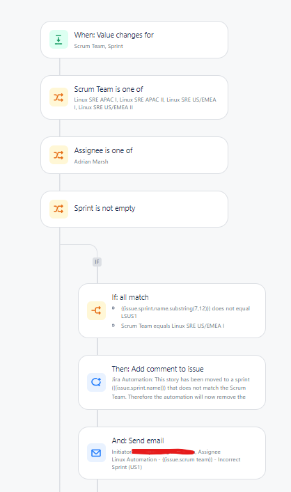

But basically:
- Limit scope - there's an IF that limits which Jiras fall into scope, to make sure I don't stomp my automation on others who share the Project
- Run the test 4 times, comparing 4 sets of teams to sprints.
For each test, its basically extracting the text out of the Sprint Name.  If it doesn't match the test, then it'll clear the sprint value, send email and make a comment.
It works, when there's just one sprint value returned.  But for stories that have passed through several sprints, I get several results.  The substring works over all the results.. the problem is I don't know which might be the "current value".

Here's a screenshot of one of the Ifs,  there's 3 more for the other teams in play, but all the same logic, just values change.
