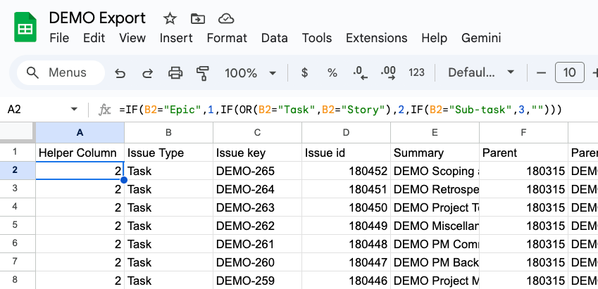

I haven't done this explicitly from the List view, but I do have an only-slightly-clunky workaround.

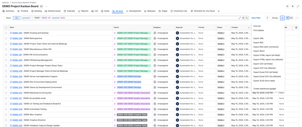

1. From the Filter / All Work views, if you include the Parent field in your export, you can do a range sort in the spreadsheet program of your choice. (I use Google Sheets.)
2. You will need to add a helper column in your spreadsheet to set Epic to 1, User Story/Task/etc to 2, and Sub-task to 3.
The formula I use in the helper column is:
=IF(B2="Epic",1,IF(OR(B2="Task",B2="Story"),2,IF(B2="Sub-task",3,"")))

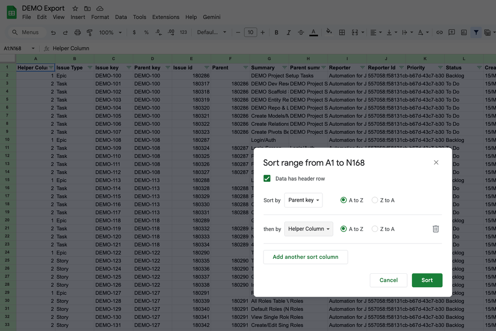

3. You will also need to copy your Epics' Issue Keys into the Parent Key column.
 4. Select all of your data and do an advanced range sort, sorting first by Parent Key (A-Z), then by Helper Column (A-Z.)List-Step3.png
I hope this helps!
