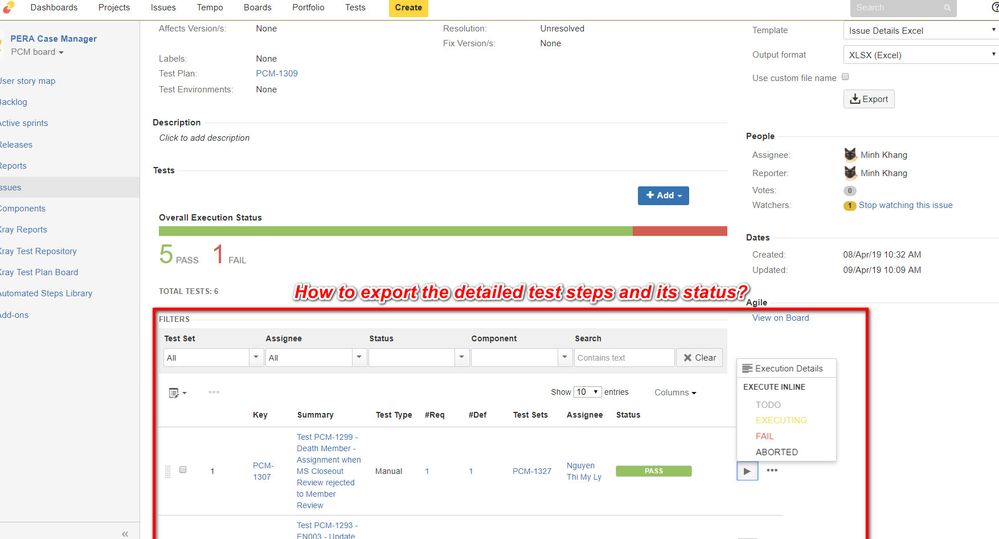

Hi all,
I have installed Xporter for JIRA as well as Xray.
However, I am stuck in using Xporter to export test steps and status of each test case. There is no Xporter buttons to support it. See the attachment.
So, please guide me the detailed instruction for this issue.

@Andrei Loutchouk : Xporter supports export, doesn't it? Here you can see the button "Export" in my attached picture but it disappears when I see the detailed test steps and results.
I recommend examining TFM: https://confluence.xpand-it.com/display/public/XPORTER/Server+vs+Cloud+Version
and contacting their team: https://jira.xpand-it.com/
I've been struggling with the same issue, and for now have a manual workaround. Additionally, there is a plugin XPORTERCLOUD that will export issue filters, but it is also limited in the Cloud version of Jira.
@Andrei Loutchouk what is your manual workaround?
Using their API to export, then reformatting in a typesetter. I found several examples, and the documentation is pretty good.
