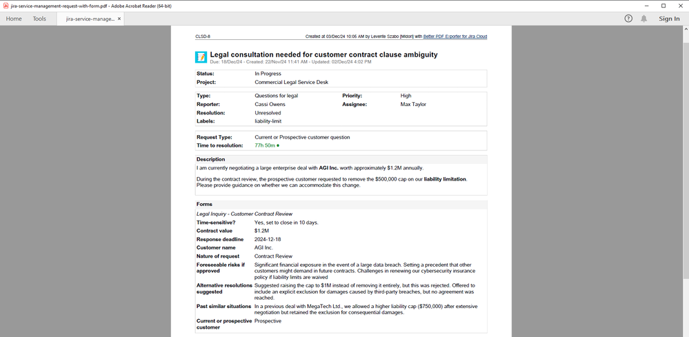

If you were on Cloud, then Jira Service Management forms can be exported with other work item details to PDF! (This integration is available. Proforma was acquired by Atlassian, and it is now part of the JSM package.) It would result in a PDF document like this:
