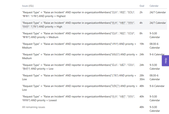

Can you do a screen grab of your Issue (JQL) section so I can see how it's set up?
Jennifer Gardner
August 6, 2018
Raynard Rhodes
August 6, 2018
The request type it is catching is "Raise an Incident"?

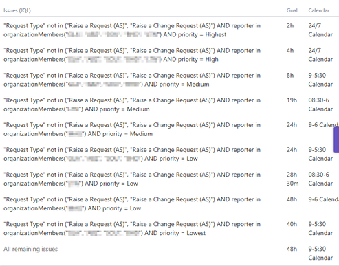

Jennifer Gardner
August 6, 2018
The 'all remaining issues' SLA still catches the request types that I'm trying to exclude :-(sla1.pngrequest.png

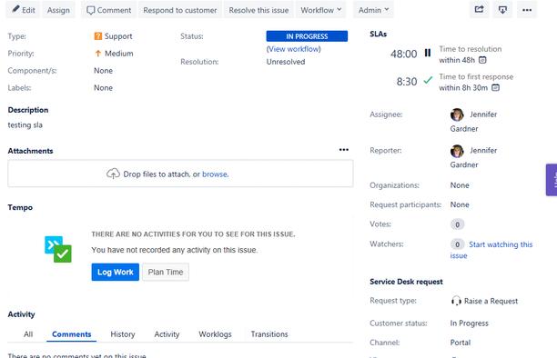

I created a new request type of 'raise a request' and made sure the organization was populated to one defined in the query but it still used the 'all remaining issues' SLA.
I might just have to exclude these request types from SLA reporting and set the SLA to '999h' or something like that so it never breaches.
