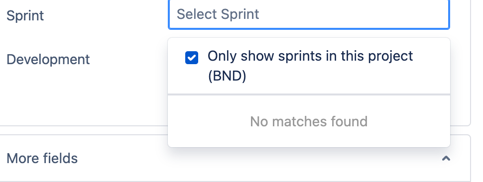

I would like to ask you, how to enable values in jira sprint project checkbox (for company managed projects)? It looks like it doesn't work (e.g. in printscreen below)....In project are existing sprints....

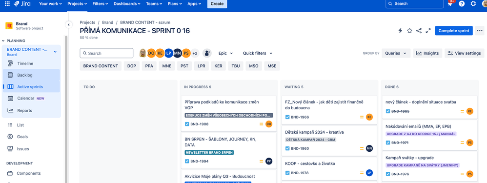

Can you provide your evidence that active and/or future sprints exist for that project? For example can you provide a screen image of the Scrum Backlog view for that project showing the project name in the upper left and the list of sprints?
Denisa Holečková
August 9, 2024
Hi @Trudy P Claspill , yes, there is only one active sprint in this project. I am sending printscreen in attachment below. But we have the same problem also in another projects...5f38764a-36f0-4cfc-8841-1246866f0d3e.png

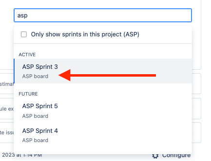

Can you confirm that the sprint display was created in the same board you are viewing? A sprint will show in the board it where it was created, and also in any board that includes issues that have been added to the sprint.
Do other users get the same results that you see?

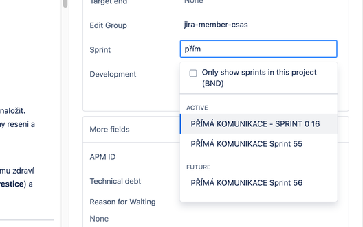

If you uncheck the filtering box and start typing in the sprint name, does it come up in the results? If so, it should show the board where it was created. Does that match the name of the board you are viewing?
Denisa Holečková
August 11, 2024
there is no information, where board was created.....
