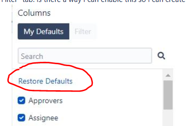

Hello,
I want to create 2 different filters for 2 Jira projects. However, the setting has already been "Default" and I can no longer enable the "Filter" tab. Is there a way I can enable this so I can create 2 different filters? Please see attached image.Filter tab.jpg
Thanks,
Norman

Hi @Norman , thanks for your question.
I have understood you are asking to restore the default view of the filter search results.
To do this from your own image, you just need to click on the option to 'Restore Defaults'
If I have misunderstood or you have follow up questions, please just reply here and either I or someone else will try to help you.
Cheers

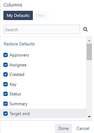

Norman
March 7, 2023
Hi,
Thanks for responding. I tried to do your suggestion. However, the restored columns are no longer relevant and I've been trying to create 2 different columns for my 2 different projects. Do you have any idea how to do this?

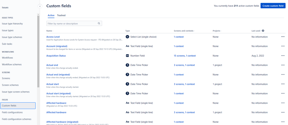

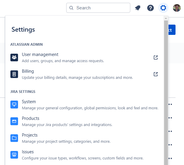

To create a custom field, you need to go into the System settings and then the Issue Menu, like this -
Then, from the Issues view, find the Fields heading and then Custom Fields. You can then click on the blue button to create a new Custom Field
Then, you will need to choose the type of field, and during the process of creation, the last step is to choose in which screens you want the field to appear. Once you have mapped the new custom field to the screens, you should be able to populate it in the project and then run the JQL / write filter queries.
