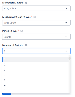

Thank you for the clarification. If it's one time case I am not sure if you need to pay for a custom app. The Sprint Report shows the last 12 sprints. So, over time you won't see Sprint 1 in the report anyway. If you see that it's a recurring case, then my app can help you with that - Multi-team Metrics & Retrospective. With it, you can even construct custom JQL metrics.
Settings for number of sprints (periods):
