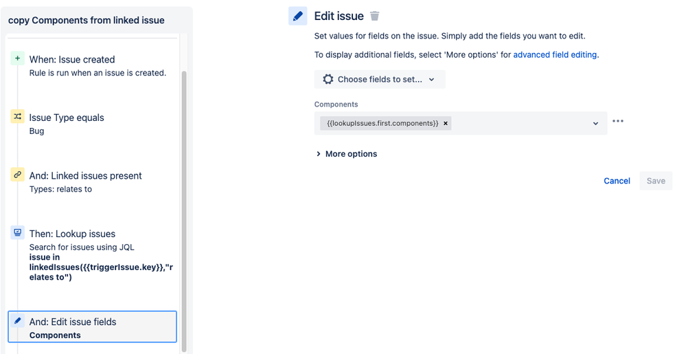

Hello @Muhammad Jahanzaib Tariq_ T-6074
You can copy the Components from the linked issue like this:
