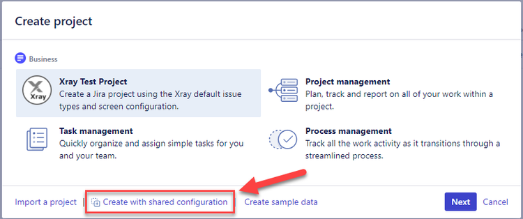

If you have already a project where you have set your desired schemes and you want to use those same schemes to the new project - then, while creating the new project - you will have an option of copying the configuration.
Choose the Create with shared configuration option while creating the project and select the project from which you want to use the configurations.
The new project will now have the same configurations as the existing project.

When you have already a project which you have modified to the schemes and you want to use those same schemes to the new project - then, while creating the new project - you will have an option of copying the configuration.
Choose Create with shared configuration option (as shown in the above screenshot) and choose the project for which you have already updated your scheme.
The new project will have the same configurations as your existing project.
