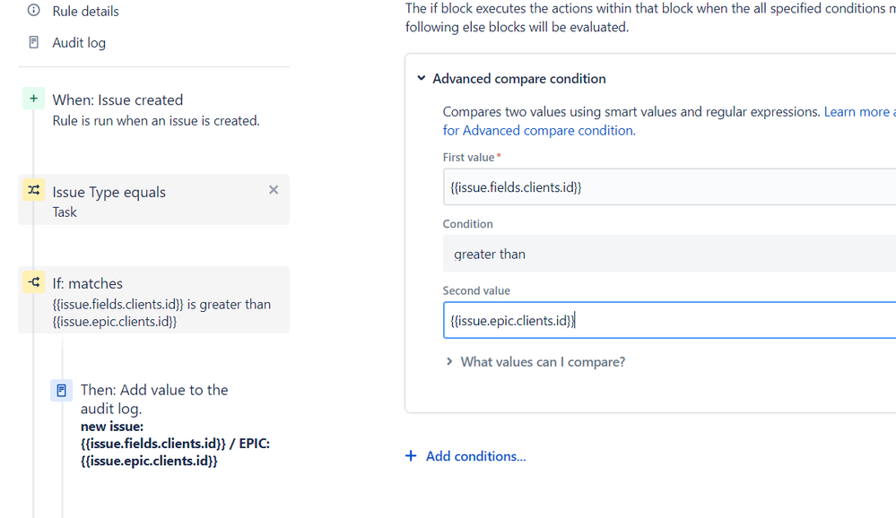

I would approach your problem with a slightly different angle, and instead of comparing the values on the right I would compare the option ids of your single select field. That is if you have the ability to set it up like below:
id value
 2021-Q1
 2021-Q2
 3 2021-Q3
4 2021-Q4
5 2022-Q1
6,7,8,9...... etc
What I would do is to actual compare the id of the selected value, instead parsing the text inside your value. So e.g. if I had set up a rule either in automation or within a workflow (with the use of an app) I would check the relation between the two selected values of the field in both story and epic. If the id of the value in story is greater than that of the Epic then:
  • either don't let the user create the story (validator inside a workflow)
  • or change the value of the story to at least match the value of the epic (jira automation, and upon issue creation)
 Would something like the above work for you?

You could either use REST API to retrieve this single select ID, or use a 3rd party app, like JMWE or scriptrunner to do the comparison on the create screen of your story workflow, or use smart values within a Jira Automation. The latter could be easier.
For example you could do the following with Jira automation:

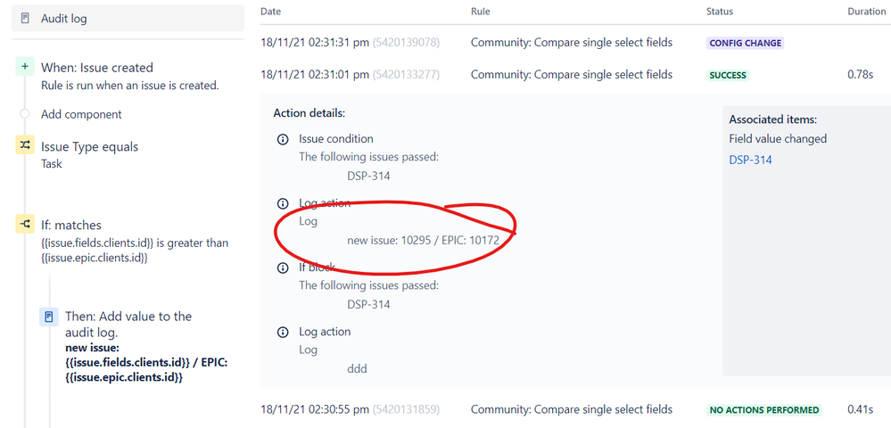

And then on the audit log you would have these results:awesomeRuleResults.png
Thus having two integers value to compare!
Happy ending, no? :)

@Alex Koxaras -Relational- thanks a lot! I'm in the middle of testing it and I noticed that the ids are not the positions (in the custom field administration) but they are very high numbers (e.g. 12131) which looks more like global counter? Fortunately they seem to be in the right order, likely becuase of the creation time/order (if they are global order indeed) but once created they cannot be influenced I guess, is that correct understanding?
November 18, 2021
Yes they will not change, unless you delete a value and create another
