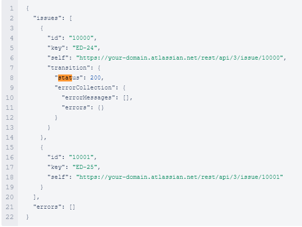

I am creating bulk issues using jira rest and I am not able to set transition in that call.
https://developer.atlassian.com/cloud/jira/platform/rest/v3/#api-rest-api-3-issue-bulk-post
But the doc says we can set transition during bulk creation.
image.pngattaching sample response from docs.

So, the issues are being created, but the transition is not happening.
