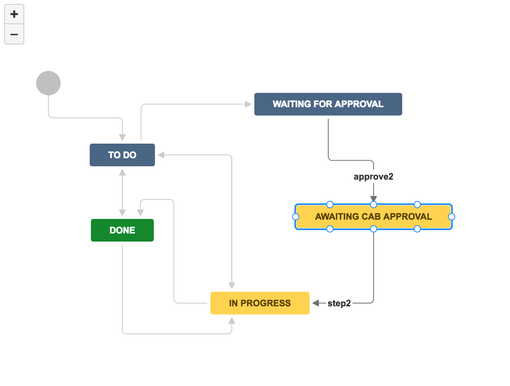

So in your case, I think you would need to create an additional status to the workflow, and then create separate conditions for each of those two separate approval phases.   Your workflow might look something like this:
This way you can have a separate conditions on the transitions 'approve2' and 'step2'.   These can be then be for users in different groups.

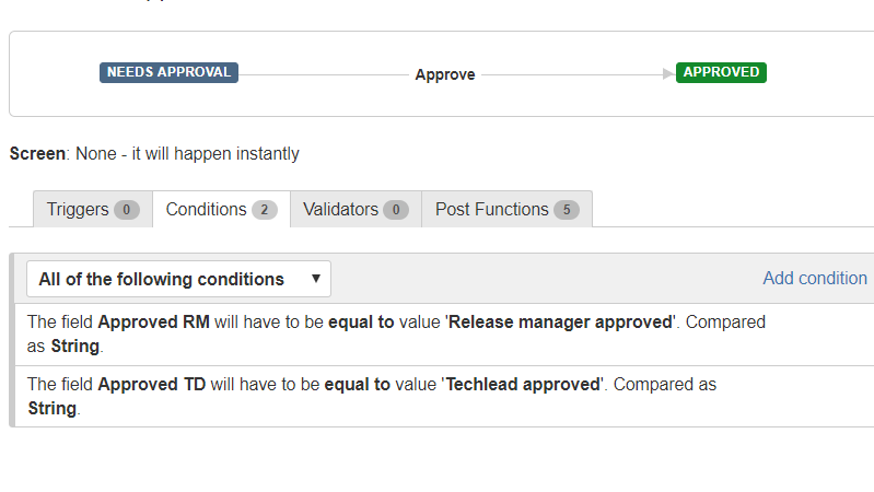

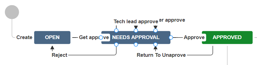

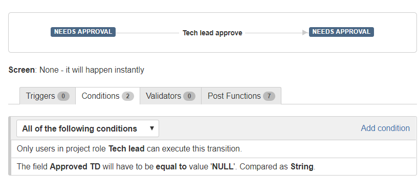

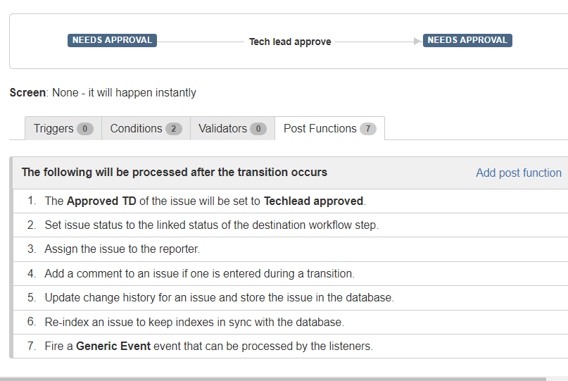

For other similar task I've done other option of WF and maybe someone will need it, because of that I would like to share it in this topic:
Снимок 1.PNGСнимок 2.PNGСнимок 3.PNGFor another approvals I used the same logic and in the end:Снимок 4.PNGBest regards,
