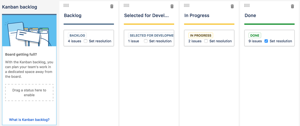

If you have created the columns in this menu, you need to find the card for the status you want to map to the column (it might be in the "Unmapped Columns" section) and drag it into place in the correct column. That should look something like the below:

Hi @Violaine Truck , this is the expected behavior then. The lifecycle issues follow is determined by the administrators of your Jira instance. This is to ensure they follow best practices and don't get modified without testing since that could affect other users negatively.
Jira gives some control to the project administrators, by adding/removing/modifying board columns, but no matter what columns are added, the back-end lifecycle that tickets follow will remain constant.
This means if you add in new columns for an issue to live in, you have to tell Jira which status in the lifecycle it should transition to when its placed in said column. A column created with no mapping to the workflow status would mean Jira would have no idea where to transition the issue being placed there.
