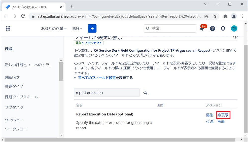

Hello,
I have created a new custom field called "Report Execution Date" and added in a screen. I found that it tells "非表示" (which means not-displayed in Japanese) in the action area of right side of the attached screen. Could you tell how I can make it "displayed"?
Thank you,
Takaki Ohashi

@Takak Ohashi
Navigate to project settings and select the option screen to have the field in relevant screens
Project Settings -- Screen -- Add the field to the screen
You can look into issue layouts once you add the field in screen to customize where it should appear on the view screen
Let me know if you have any queries
Thanks,
Pramodh

Thank you for the instruction. I was able to add a new custom field to the screen but I cannot confirm if the field appears in the screen. I cannot see the selection for "view screen". could you let me know how I can get there?
Thank you
