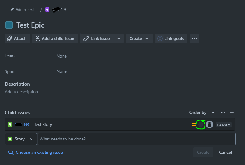

In my projects I have the usual hierarchy, Epics as parents of Stories. When I open the Epic I get the usual Child issues view. Where I circled it green it shows the Story Point value which we don't use, we use Original Estimates instead.
I have already removed the Story Point field from both Epic and Story issue types and I'm looking for a way to display the Original Estimate here in the Epic view instead of the Story Point value.
I've been looking everywhere but the solution for a simple problem like this seems to be well hidden.

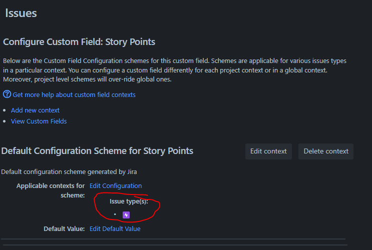

I have been in touch with support, unfortunately the story point field can only be hidden, not replaced. There is a feature request to customise the child issues view: https://jira.atlassian.com/browse/JRACLOUD-70206
To hide the story points field from child issues you can edit the context of the custom field Story Points and remove "Stories" from the issue types.
