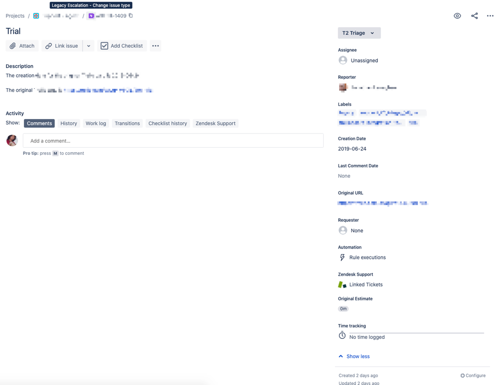

I'm not seeing it unless I hover over the icon.

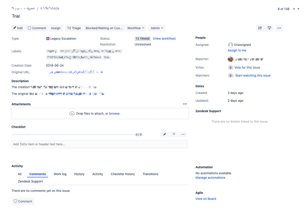

For reference, this is the old view:
And below is the new jira issue view where I have to hover on that itty bitty icon
