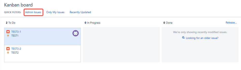

Basically what we're looking for is a way to make the Kanban board page as easy to search as the Issues page. So I think the problem is not about the JQL, but the quick filters, which currently cannot be configured to accept user input.
For example,
I can create a quick filter that uses the JQL below to get all issues assigned to the admin user.

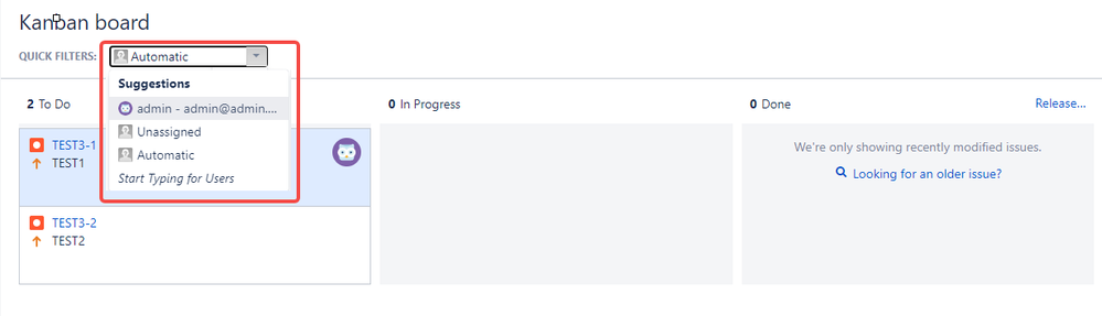

But since there could be lots of users, we would like to provide selectors for the users to make their own search conditions, like the one below
Besides, filtering by assignee is just a simple example; in a big project, the searching conditions can be much more complex that simple grouping usually helps little. That's the reason that we're considering developing a plugin to achieve this.
I have some ideas about how to render some customized input boxes on the screen, but I don't know if there's a way to make them interact with the board (dynamically filtering the board).
