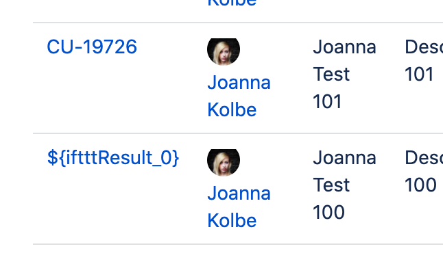

jokolbe
August 14, 2020
There is no error that I see on form submission at all. I just dont see the issue created nor I get any issue number back
jokolbe
August 14, 2020
My apologies, I had an extra condition on the IFTTT !due:[empty] that I didn't remove
Working perfectly fine!

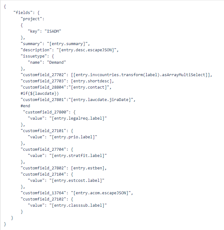

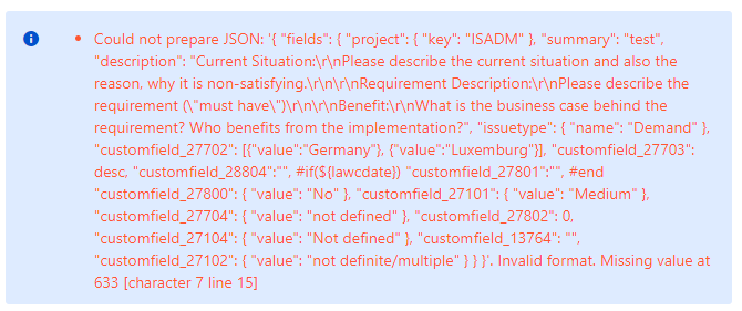

Hey @Alex Medved _ConfiForms_ ,
I tried this with a date field the same way. It is suppose to be optional and should only provide a date, if the field is filled/ a date is selected. Otherwise there should not be a date parsed to Jira.
However it throws an error regarding the if clause.
Do you have an idea what the issue is? Thanks in advance.
September 15, 2021
Most probably, in your Confluence instance ConfiForms has an option to evaluate the contents as Velocity template disabled
https://wiki.vertuna.com/display/CONFIFORMS/Release+Notes?preview=/31096895/49415735/confi-conf-velocity.png
Could you check with you admins?
thank you very much! It was indeed disabled. Now its working perfectly!
