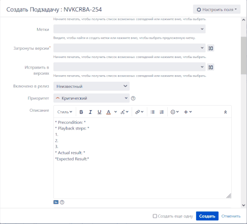

Hi,
We need to place a text template in the Description field on the subtask creation screen. How can this be configured?
I set up description filling with Behaviors. But the completed template cannot be edited during creation, all changes are not saved. As a result, the subtask is created with the description specified in the script.
Script:
def srd = getFieldById("description")
def defaultValue = "* Precondition: *\n"+
"* Playback steps: *\n"+
"1. \n"+
"2. \n"+
"3.\n"+
"* Actual result: *\n"+
"*Expected Result:*"
if(getActionName() in ["Create Issue", "Create"]){
srd.setFormValue(defaultValue)

Oh ... where do you have your script? Did you put it in the description server-side script?
If so, then that's would be the issue.
Default description scripts have to be put in the initializer. Otherwise, each time you edit the description, when you leave the field, the script executes and resets the field.

Indeed, the script was not in the initializer. I moved it to the initializer and everything worked as it should. Thanks a lot!
