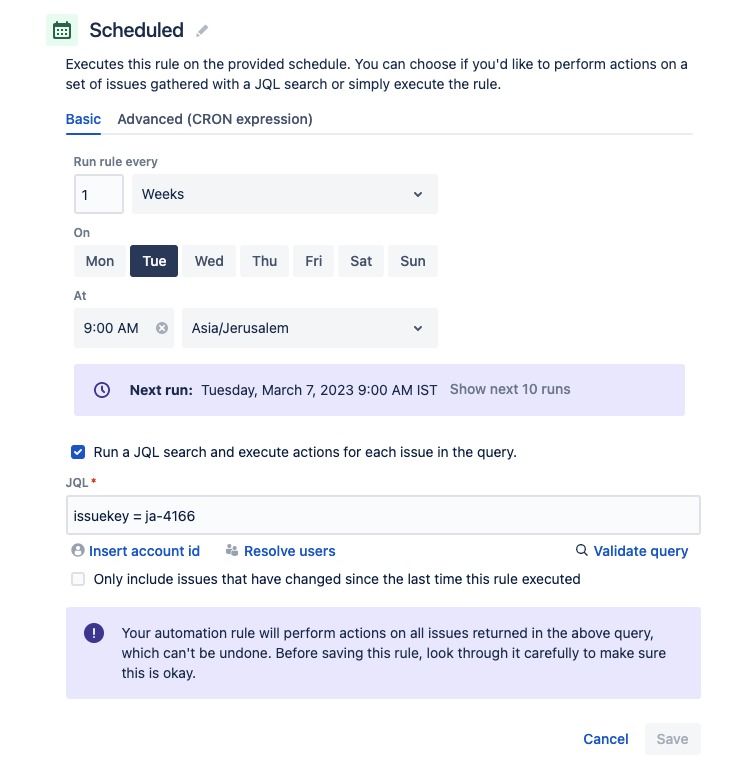

I can't run the rule without JQL
Bill Sheboy
February 28, 2023

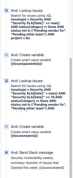

Please post an image of your entire rule, as I believe that will show you are referencing issue fields and not just the created variables or the lookup issues results.
Hadar Dinte
March 2, 2023

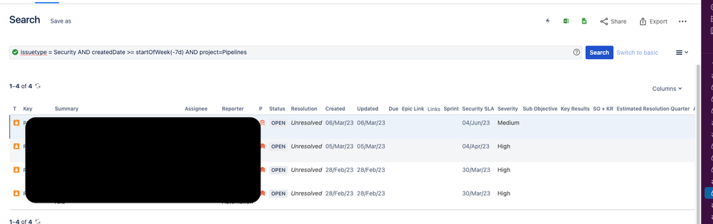

I dont know if it's elegant work, but I wrote a Query in the JQL tab that the result of this query is 1 issue - so in the end I got only 1 message of the summary.

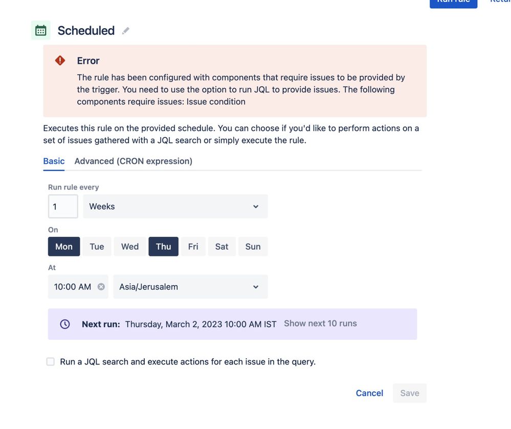

Until you post the image of your entire rule, I don't know how to answer the questions you are asking about the errors.
Hadar Dinte
March 4, 2023
Ok,

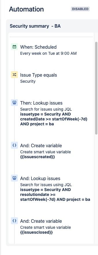

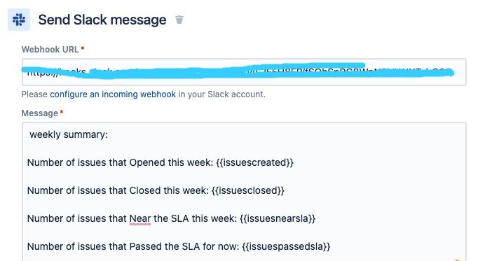

Here are the images of my rule
Thank you!
WhatsApp Image 2023-03-05 at 08.47.33.jpegWhatsApp Image 2023-03-05 at 08.49.15.jpeg
Bill Sheboy
March 5, 2023
Thanks for that information.
When posting an image of long rules, I recommend using a browser extension (or app) which can capture a complete, scrolling browser tab view.
Back to the error you observed, the cause is because the rule is referencing an issue's fields in the condition test on Issue Type.  That condition is not needed for the scenario you described.
Instead you can do this, as I suggested earlier:
  • trigger: scheduled with no JQL
  • action: Lookup Issues with JQL for issues created.  For example...
    • project = BA AND issueType = Security AND created >= startOfWeek(-7d)
  • action: create a variable to save your issues created count.  For example...
    • variable name: varIssuesCreated
    • smart value: {{lookupIssues.size|0}}
  • and so on for the other counts...
  • action: send Slack message, referencing the Created Variables.  For example...
    • the number of issues opened this week: {{varIssuesCreated}}
Please note there is no JQL for the trigger.  All of the issue information comes from the Lookup Issues actions.

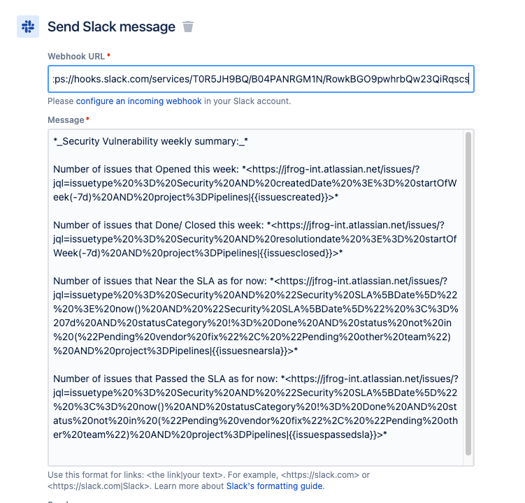

Now, I would like that the numbers that I get in the Slack message will be hyperlink, and will lead to the list of the issues.
I tried to add the world URL to the new smart value in the slack message, for example: <{{issuecreated.url}}> but it is not work
Can you help me with that, please?
Bill Sheboy
March 6, 2023
Created variables are text, and so there are no other attributes, such as url.
I can think of two ways to do what you ask with a link to the issues...
a) Add links for each issue in the lookup after the number, with
{{#lookupIssues}}{{url}}{{^last}} ; {{/}}{{/}}
b) Use HTML formatting and encoding in your Slack message, and make a link for the number as a reference to a JQL search of the issues. For example,
<a href="https://yourJiraURL/issues/?jql=JQL from the lookup">{{varIssuesCreated}</a>
This can also be made dynamic if the JQL and URL values are stored in variables and combined later.

I didn't succeed with the first option.
For now, I passed the Query's URL to the slack message. Unfurtantelly it's not elegant work, but its work
Screenshot 2023-03-07 at 11.24.57 AM.pngScreenshot 2023-03-07 at 11.19.17 AM.png
