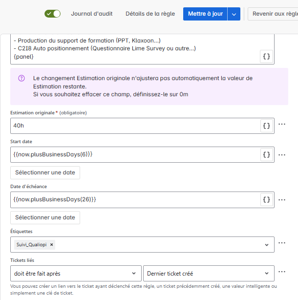

Aline Veyradier
June 23, 2025
Trudy P Claspill
June 23, 2025
Thank you for those images. That is helpful.
I see that you have set the Linked Issues field to link the current subtask being created to "last item created". Is that not working for you?
What results are you observing?
What information is being recorded in the Audit Log for the rule execution?

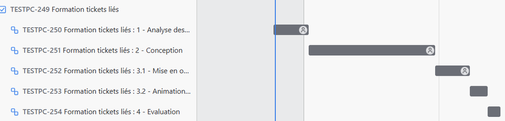

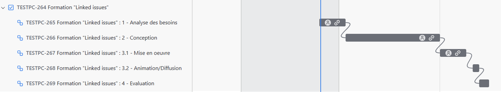

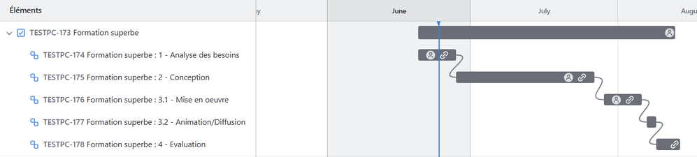

That's what I'm aiming for :
And that's what I get with the Linked Issues field set to link the current subtask being created to "last item created" :

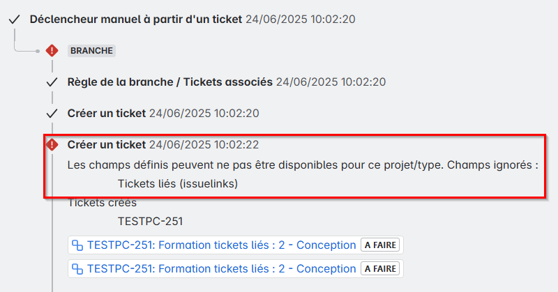

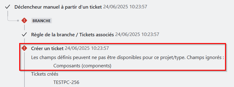

Nothing happens and I get this error in the audit log :
which means : "Defined fields may not be available for this project/type. Disregarded fields: Tickets liés (issuelinks)".

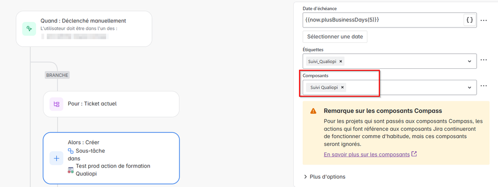

Strangely, I'm having the same problem when I try to add a component to the sub-tasks :
But it works well with labels...

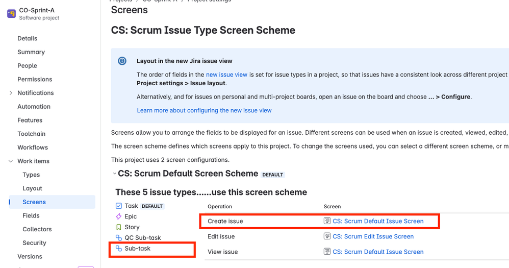

Trudy P Claspill
June 24, 2025
Hello @Aline Veyradier
Thank you for those images and additional information.

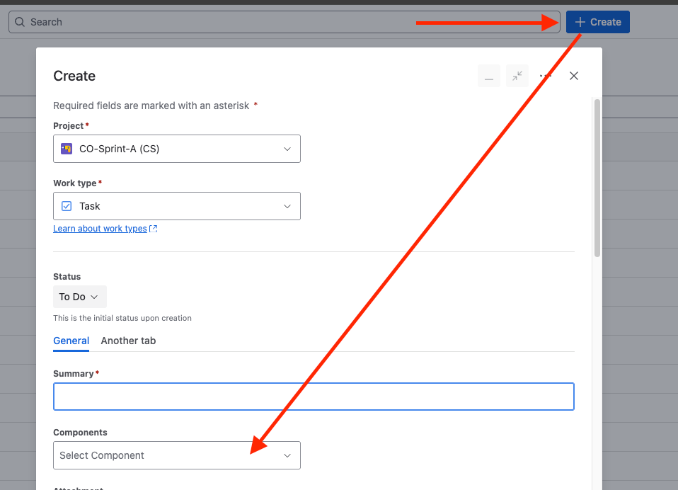

That message means that the fields are not present in the Create screen that you get when you manually create the same type of issue.
In order to set a field in an Automation rule in the Create Work Item action that field must also be available to be set manually through the Create dialog that you get when you click the Create button at the top of the Jira screen.
If the field is not present there in that dialog, the Automation rule cannot set it.
If this concerns a Company Managed project, you would need to add those fields (Components and Linked Issues) to the screen used in the Create Issue operation for the subtasks.
