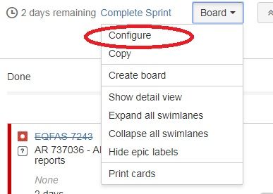

How to create separate boards under one project with different epic /Story/Issue/Subtask. Whenever I am creating new board it is getting all details from the previous board. Help me to create a new board where I can create new epics and all

The board is just a view of the tickets that you set through the board filter. On the top right corner you can see icon BOARD, press on it and in the drop down choose CONFIGURE and here you can set up your filter that corresponds to all the requirements.
If you have 3 teams in 1 project, you can filter those cases based on the Team or Label - anything that suits you best.
So for example board's filter would be:
project = EQFA AND "Scrum Team" = "Team 1"
project = EQFA AND "Scrum Team" = "Team 2"
project = EQFA AND "Scrum Team" = "Team 3"
So if you set those different filters for the boards, you will see issues
that were assigned to each team.
