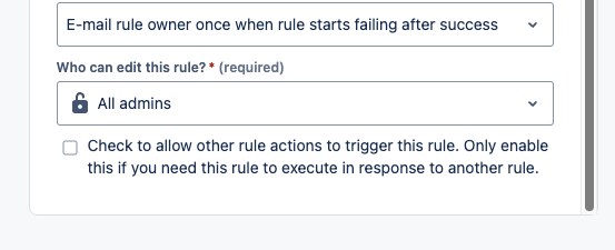

If your issues are linked in a chain, then on the Rule Details page you need to check this box:
Then the update of HA11-3 will cause the rule to be triggered again for HA11-3 and update the issues linked to HA11-3, and so on through the chain of linked issues.
However this sort of trigger-itself action is limited to 10 such executions. If you have more than 10 issues in the chain additional actions have to be taken to address that.

Thanks @Trudy P Claspill . Selecting that checkbox fixed the issue.
